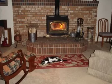

We had an old wooden mantle consisting of a single huge timber. Ripped it out and had the mason who built our hearth replace the timber with a brickwork mantle. Came out very nicely. You can just see it as a couple courses of darker brick across the top of the pic. Rick
  • [Hearth.com] Englander 30 mantel clearance?
Look carefully on the top of the mantel to see if they screwed from the top, then plugged the holes and sanded the plugs flush.
Ours was fastened from behind. Not screws, but big nails. I believe how it was done was driving the nails partially into the timber, setting the timber in place on the masonry, and then continuing the masonry work, thus embedding the protruding nail heads in mortar joints between brick courses. had to wrestle the thing loose enough to get a sawzall blade down in there & just muscle it out. Wasn't pretty, but we got 'er done and it turned out OK in the end. Rick

I imagine a skilled brick mason could figure a way to incorporate the existing supports into some sort of new mantle. Kinda tough to tell from the avatar pic, but I know my brick mason would come up with something...he's that kinda guy. Loves a challenge. Rick
