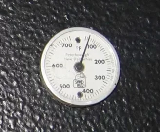

That is pretty high and I would not run my stove that hot regularly. Cudos to Kuma for building such solid stoves. However, you are asking the same questions that any user has: What is a safe operating temp? How high can I go without damaging the stove? When do I need to interfere with the burning process? Stove manufacturer's simply place that burden on the consumer who have to come to places like here to get an idea how their stove is operated properly.
I don't think that is what I said. If the manufacturer stated not to heat the stove above 900 F that is it. How that temp has been reached is irrelevant in that case. Why not simply include a $10 stove thermometer in a $2000 purchase (in most cases) with detailed instructions in the manual how to use it to get an efficient burn that is in the safe range? I don't think such a thermometer exists yet but you could easily add a second needle that only moves forward and shows the highest temp reached so far. If it goes in the dark red the stove should be checked by a licensed installer to make sure it is still sound. That is what I would call customer service. Not only sell people a stove but also show them how get the most out of it while operating it safely.
800* is kinda the max target before completely shutting the air off. I certainly do not run there for any length of time. I wasn't poking at you with any of my comments, sorry if that was perceived. Also, the temp gauge you described is brilliant, showing the max reached temp. If it could be invented, could it be tamper proof? I am suggesting some changes to our manuals as well as researching the availability of a custom temp gauge to give model specific readings, to be included with each stove.
As indicated above, max temp may not actually be black and white. Even if it is a bit more grey, it's a dang important piece of info that admittedly, we haven't done a very good job of addressing. Perhaps something like this (I'm making it up as I go here):
CAUTION:
Your Kuma Stove is safe to a maximum surface temperature of 850* (see diagram for temp gauge location). Sustaining temperatures of more than 750* is over firing and will reduce the lifespan of your stove. Optimum operating range is between 500* and 700*.
