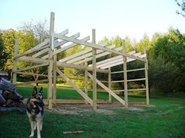

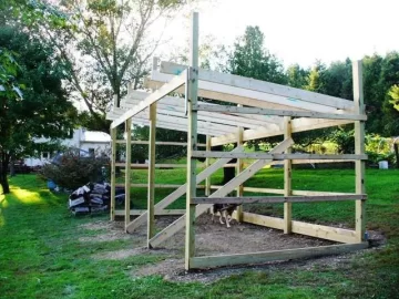

Here's where I'm at with the shed. Not bad progress so far considering we took a week's vacation and I'm mainly only working on it weekends when it's not raining and wife has no other plans. With any luck by Saturday I'll be able to get the final rafters up and cut off the post tops. Hope to be picking up the metal roofing this Sunday and then it will be time to start bringing in the fuel. Looks like my mid October finish date is a real possibility. I'll be a happy camper when I can put up a photo showing a filled shed! Appears the shed has the approval of the local wildlife and the neighbor's dog.

Looking good.
Metal roof will be sweet!
Nice pictures,
The dog is the local building inspector & security? Good deal!!
Nice start on that wood shelter! You'll wonder how you ever got by without it!
Ray

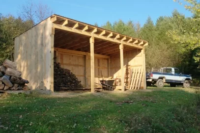

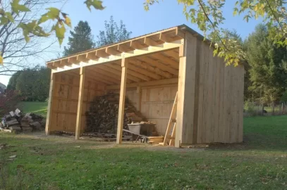

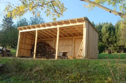

OK, almost made my self imposed deadline of this weekend. Shed is about 92.5% done :)
A couple of 10" bolts, fascia boards , rain gutters, some backfill with drainage ditches, some sort of hanging cover system to protect against major storms and I'm completely done. Well almost, I have to fix the overhang on one side as I screwed up big time and this may wait until next year as I'm getting pressed for time to get her loaded and to get out there and run the saw...have not cut any wood in 2 months!

Very nice & "new " looking.
Great job!
Best picture will be when it's full. :)
This is just a suggestion, and I'm no structural engineer so take it for what it's worth - but I'd consider putting some diagonal bracing here & there. Maybe at the top corners on the front, and even a couple top to bottom on the back & sides. I've seen some leans develop on strapped/boarded things before.
Nice looking shed though!
More bracing is another item yet to do and there's probably a thing or 2 that I just can't think of right now. Getting her loaded is priority#1 for now though since we have started to burn wood.
Looks great muncybob! +1 on the braces like Maple1 said. I think bracing in the front would give it a good look as well as the structural benefit. About how much wood will that hold?
Looks awesome! Structure like that is useful and makes the property look better too.
This will be my first year trying to actually heat with wood in awhile, going to be wishing I had a shed like that, nice job.
