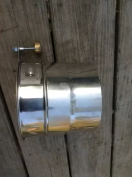

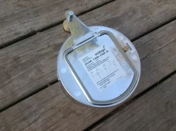

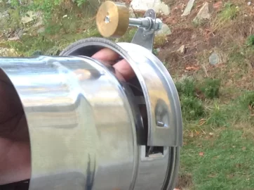

Windhager has a barometric damper with spring assisted explosion relief; see pictures
These are used in Europe on almost all gasification wood boilers
