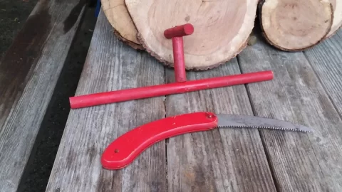

A measuring tool I put together that's 17 1/2 inches long that I lay on the log and then give a couple strokes with the folding saw to score where I want to make the cut. I can go down the log and make numerous scores and then proceed to cut up as many pieces as marked. All the exact same length!
