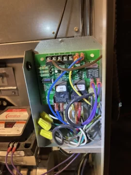

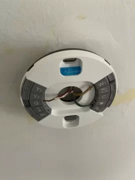

So the other day I put on my thinking cap, did some online searching, popped the Nest off the wall, and discovered that our thermostat had a third wire, not connected to anything. Further Googling told me that this could be a G wire. I went into the basement, took the covers off the furnace, and discovered that it had a spot for a G wire to attach as well.
I connected the third wire, switched the power back on, and the Nest recognized it. Now I can run just the fan … which is notable because the air return/intake for the forced air system is in the same room as the woodstove.
