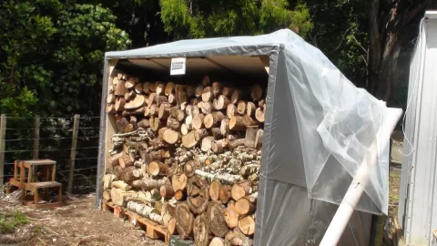

Pretty cheap to build an insulated solar Kiln to dry firewood. After cyclone Gabrielle damaged a bunch of trees on our property we built an insulated wood shed with a solar panel powered fan to dry the wood faster. Hope I can figure out how to attach a photo.
