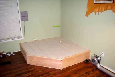

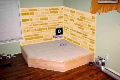

Got a couple piccy's here.
One is the actual setting at present with the grouting all done on the tile.

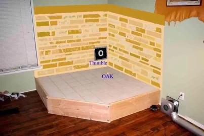

NOW I took the liberty of tossing the pix into photoshop and giving it a little massage to get a "HOPEFULLY" realistic idea of what the finished "Faux Stone" paint magic will look like when completed.
We have the paint sitting here so I just sort or hacked some colors together in the Pallet on photoshop that would be in the same sort of ball park and fiddled with it a bit.
Even tossed in the wall thimble just for giggles.
Here it is.
Snowy

Now after looking over the Photoshop workup, I am excited.
Today I am going to get going on the actual Faux paint work on the wall.
Need to mask off the area and get the Base color done first (Will define the grout lines)
Once the base is good and dry,I can tape off the area that will be the actual grout lines using Blue masking tape (does not stick hard to base paint)
Then its a matter of using a natural sponge to dab the colors onto the areas that will be the stones.
We picked a grout color and 3 colors of BUFF that will be the stones.
I used a dry sample of the grout color and had the paint store scan it with their computer scanner tool and then "HOPEFULLY" match the grout color so the tile grout and the stone wall grout will be the same. ;-)
Once the paint work is all done I may add a trim moulding around the "STONE" area to add a finished look and possibly a little bit of depth too.

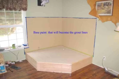

UPDATE
Got the base coat of paint on the wall now and need to let it dry well before I can start the taping process for the grout lines.
Thinking about using 2x6 for a top border above the rock look.
Here are some more piccy's of things and the concept for the boarder.
Snowy

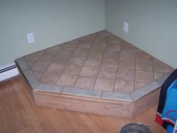

Wanna see something scary? Here's a pic of my hearth right after grouting.
Look familiar?

I left the wall alone. I'm looking forward to seeing how yours comes out.
I could have used that tile cutter you've got. I did all my cuts (lots of them) with a masonry blade on my small table saw.
With all of the tiling that I've done I wish I bought a wet saw a long time ago. I always just figured I could get away without it.

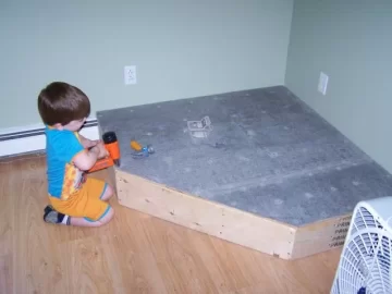

I put my grandson to work.....:)
