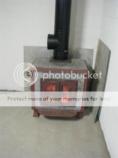

This was the old color which I was never happy with. It was supposed to be light brown, but it turned out to be rust brown. And the finish did not hold up well at all, chalked up and would come off on your hands:
[Hearth.com] Hearthstone H1 - Uninsulated basement vs insulated basement = WOW!!
hi motor
what year is your stove? i have a shiny dark brown H2. i ask because your stove has what looks like 12 stones on top and nice handles for the damper and the doors. mine has this t handle thing that slides into a receptacle and then turn which is not so nice looking or good for arthritic hands and three stones on top. nice looking setup.

fbelec, it's a 1986. I think yours is a Hearthstone II....look at this old thread on an excellent re-build of a II:

Wasp, not dumb, Hearthstone and Woodstock are two American companies that build stoves with thich soapstone "tiles" on cast iron frames. They have been around since the early 70's, both are still in business & doing well. Soapstone has excellent thermal retention properties, radiates a softer heat than iron and takes hours to cool down once hot. On the other hand they do take several hours to come up to temperature, so not a good choice for occasional use where you want heat right now such as in a cabin. Mine will run 24/7 once we get into winter proper.
