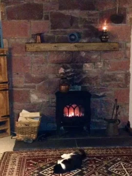

Thanks again... Hope I managed to upload a pic ok!

Well, it's been partially down to the administrative disorganisation of the company - that kind of set the tone... Saying they'd arrive at 9am and not turning up till 3pm, etc. But that aside, with regard to the install, they took two days, day one was prepping the hearth and doing most of the cementing that was needed, so that it was dry enough for the stove to go in on day two. That seemed fair enough, but on day two they had to do more cementing to close up the old fireplace opening, above the rear flue, where it goes into the wall. So more cementing and some bricks in there too, then within an hour they lit the stove. Tell me if I'm wrong, but I thought it was not good to expose drying cement to any sort of heat...
Anyway, the third day the cement that had been added on day two was very dry, dusty.. I touched it with my finger and it fell apart, creating a hole into the old hearth space behind.
They put a flue into the old stone chimney... and lined between it and the inside of the old chimney with something that they described as 'lots of little balls, poured into the chimney from a sack or two", but there is no register plate... They said that's only necessary when the flue goes out the top of the stove,rather than out the back and into a wall... Is that correct? If it is I'm confused about the liner (balls) they have put in; what is holding them in place? And why aren't they filling the empty hearth space that has been exposed by the hole in the cement?
Part from that, just things like putting the mantel back on squint (till I said, "no way!") and some broken stonework that I will need to fix somehow...
Anyway, I could go on, but this post is long enough for you to have to read ... Does any of what I've said sound suspect to you?
Wee update... I sent pics of the crumbling, falling away cement to the installers and asked for someone who is qualified to come round and fix it.. Guy came within hours and was very apologetic, says he will fix first thing on Monday morning. I was right - and of course you will all know this - they should not have lit the stove as soon as it was installed and the top cemented section was still wet. I actually questioned this on the day, they said, 'no problem'. Amazing !
When the grown up comes back on Monday, I will of course ask him why the company sent two beardless boys to do a job they were clearly unsure about. I will also express my very understandable concern that there may be other botched aspects to the install I simply don't know about... Yet.
I'll make sure I have all my questions in line in time for Monday morning...

I suspect the wierd white balls are perlite. If that's what they used, it's normal chimney insulation. They didn't put in a blockoff plate and let the perlite fill the fireplace cavity instead. I can't find any fault with this, but may be missing something. The cement work just sounds like a rush job. Patience is not a common virtue in youth. It will be good to get the bosses eyes on this.

Gyrfalcon... Yes the company from which I bought the stove did the installation and yes, I'm sure the grownup is keen to see me happy. They are a local firm, family run. News travels fast around here and I think that may be my saving grace.
Begreen - I'll ask the beard about the balls (I'd better stay careful with my language here!!) I had thought like you that there would be no harm if the fire cavity was filled with the insulation.. But it isn't - it's empty... I can tell, because that's were the cement is crumbling and falling into.. So I'm wondering where said 'balls' went! I can hardly wait to find out.
I think the poor impatient youths are in real trouble, bless them. I get the sense - and I hope I'm right, in a way - that I may have just experienced the whole outfit on a very bad week. The grownup has been off sick most of the week and so were a few others.. There is a flu bug going round just now. I can see their point, if they had cancelled all this week's installs, probably till the new year, cos the experienced workers are ill, I bet the customers wouldn't be too happy, by the same token, we're not happy with the apprentice-piece installs we got either.. A case of - 'damned if you do, damned if you don't' for the firm....

There must be some type of block off if the perlite didn't fill behind the stove. Might be another question to ask the bearded one. Does this have a block off. It will be good to know
Jags - I almost missed your post... I will ask about the perlite and block off. The boys did say that the chimney was quite narrow at the throat and on the whole didn't take much insulation, so maybe it just jammed at that point. I'll see what he says. I must say id kind of like to have the hearth space filled too, just feels more complete somehow... There's also an outside door where the old fireplace ash box used to get pulled out to be emptied. Feels like all of that should be closed up, sealed and filled to me, if only for a little more insulation generally. I'm also sure the wind will whistle in through that way in really stormy weather.
Filling the void around the stove is not typical but I don't know that it is wrong. Sounds like another q to ask

By the way, your install may be problematic, but the stove against that stone looks just wonderful and very cozy.
Maybe you can peek through that outside cleanout and get a looksee at how and what they did. Most important will be using the right materials and 3 screws per joint.
Oh I will... For sure... Three screws per joint? What joints?

Aye, I'm pleased with the finished look of the hearth. That's our local red sandstone; the cottage is a mid 1700s shepherd's cottage and is built of that stone. I've been here for 20 years now and I love it. Love the cottage and love the whole area. Only in the past two years have I been able to afford to make significant (but sympathetic to style) improvements on the cottage. Going as green as possible has been important to me, but it's not always so easy in an old stone building. Government 'green grants' are great over here just now though and have helped a lot.. My jotul is the cherry on top of that cake and it fits in well with the rest of the place.
Each pipe joint should have 3 screws, 120 degrees apart, securing the pipe. Same at the stove's flue connection.
Ah, I see... Thanks for that. I'll check. I only have the flue connection and one 45 degree joint right after that.. Then it's the main flue, so it will be easy to check.
All good today.. A guy who really seemed to know his stuff came round and recemented the hearth,really taking his time to make it as good as it can be.. He answered all of my questions about the stove, the insulation, etc... and I feel much more at ease now. He admitted he should have come to do some parts of the install himself and was apologetic.
Of course I can't use the stove tonight - the new cement is drying! But I am already looking forward to lighting up again tomorrow.
