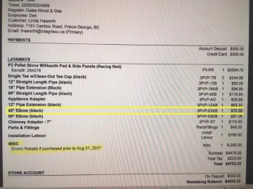

When it gets colder and you set it up higher the pot will stay clean longer. There are many stoves that dirty the pot on setting one and two. If you don't mind what did you pay for the stove?
The stove price was good. Was the pipe $900.00?

show me a $76.00 45 in the picture!

Tell them it needs to be like this on the inside and ADD 4" from the ceiling to the termination and a nice cap! you have paid more than enough for it all already
Well if I can ever get them to reply to my emails I will. I will be stopping by there on Thursday to have a chat with them
I don't like to knock someone else's work, but your manual will say not to exceed 25 EVL in your manual. And who's idea was this chimney? I'm also curious who inspected this and passed it? There's two hours at the most to install this and that's heavy, but that isn't what's most bothersome. I've been told Canada is stricter on inspections than the US. That would fail here. Just look at your manual.
