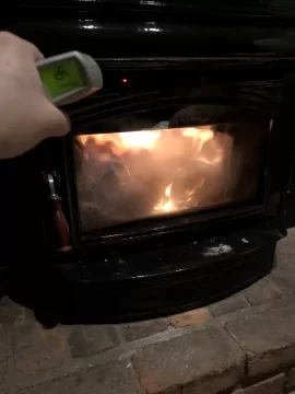

Here is a picture from tonight. I’m measuring under the top plate where the blower blows out. The highest temp I got was 512 and the air is turned almost all the way down.
I just aimed my IR gun at the slot. Highest I got was 250f. The therm control (thermocouple on stove top) reads 344f. So, like 100f low.
I got a more accurate matching reading by pointing at the top of the door glass.
