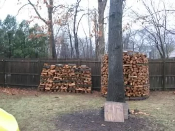

These are some pics of the three i have in my yard. The views of the yard pics are from a second story window and the back slider. The pic with the HH and the stack was how my experiment started, and the tree is the red oak that was taken down and hit the HH on the right.
  • [Hearth.com] Holz Hausen Experiment - Results are IN!!
Archer, to state the obvious you have a solid privacy fence, one of my HHs is 12" from my dilapidated garage so I've been concerned that the sun has been blotted out too much . . given more property I'd find higher and sunnier south facing ground, that -has- to be 50% of the battle with drying out. But then I have to ultimately get permission from my wife on where these beasties go . .and I think for most the -best spots- would get veto'ed by their significant other, mainly for appearance and safety concerns
. . anyway great looking HHs
Adios Pantalones said:
I'm coming to visit
