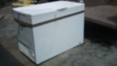

    Thanks for all the input. Picked up this 5 yo 15 cu ft Frigidaire commercial chest unit I found on Craigslist. Just in time too, we picked 6 more gallons of strawberries last night and had no where to go with them.

  24. smokinj
    smokinj
    Aug 11, 2008
    15,981
    1,412
    Anderson, Indiana
    I know where to go this winter! Thanks for posting.........lol :lol:
