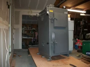

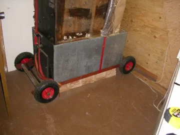

I have made a dolly that can be completely assembled and dissembled around the boiler. The frame sections are just bolted together.
Using a fulcrum (pry bar), the boiler is raised a corner at a time just high enough to slide the angle iron sections under the boiler and then are bolted together.
Using a fulcrum again with blocking, the entire frame with the boiler on it, is raised gradually until the wheels can be put on.
Depending on the grade, using a come-along, chain blocks, rope blocks or pry bar, the dolly can be easily maneuvered.
This frame without the wheels on could be used to slide the boiler down a concrete set of stairs.
Once the boiler is to its desired position, reverse the assembly and you are done.
The Jetstream boiler on this dolly weighs 1,500 lbs and I moved it down a 50% grade by myself!
This is my new spare Jetstream blocked up off the floor. Who knows how long it might sit here.

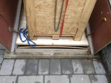

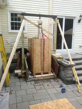

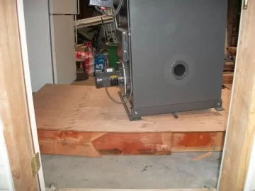

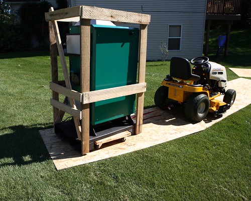

Windhager BioWIN260 pellet boiler going into a basement: 925 Lbs.
The pallet truck is in the basement already to move it easily around.
Platform consists of 2x6's cut to length. They will be taken out one-by-one once the BioWIN pellet boiler is lifted

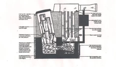

When I'm burning really dry wood under 7% moisture content, I can only burn 50% of a charge of wood. At that low moisture content, more smoke is produced than can be burnt cleanly. There is still no appearance of smoke coming out of the chimney but there is a smell very similar to that of bunker "C " being burnt.
[Hearth.com] How did you get your gasifier in your house?
The Jetsteam is different than its modern cousins. It just burns off the bottom of the charge making it easy to reduce fuel by reducing the amount of blocks. Instead of burning 4 blocks at one time you would burn only two or three.

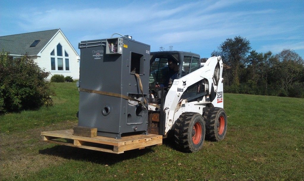

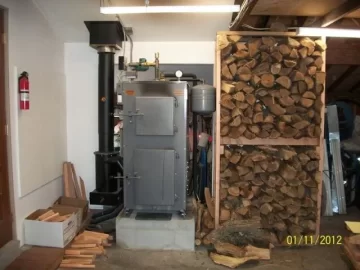

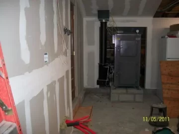

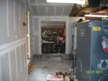

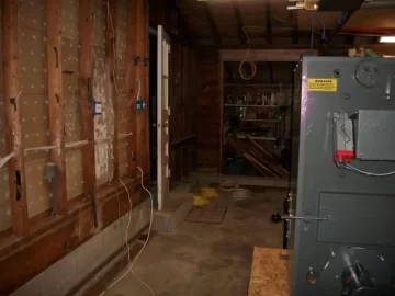

I don't think there is much of a difference in smell. Sometimes it heavier than others but I don't want to hijack this thread. Here is how I got mine on the concrete pad.
It was on two pallets when they left it in my garage. Then I built a platform from the skids to the concrete pad (it was slightly up hill) and by myself with a pipe and pry bar I spun it 180* and rolled into place. ;)[Hearth.com] How did you get your gasifier in your house?[Hearth.com] How did you get your gasifier in your house?[Hearth.com] How did you get your gasifier in your house?[Hearth.com] How did you get your gasifier in your house?[Hearth.com] How did you get your gasifier in your house?[Hearth.com] How did you get your gasifier in your house?
