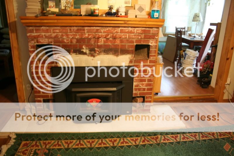

We tiled around the insert over the brick. Still plan on metal grates for the "still working" heatalator vents, but for now....

I had the same utilitarian black surround with my Buck. Decided to go without. I like the way it looks better and I'm convinced I get more heat out of the whole setup.

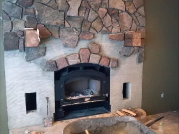

maybe frame around your insert with metal studs, put up some durock board, and do a natural stone veneer over the whole face of your fireplace........I'll walk you through the stonework, Ralphie. I've done a little bit of it......:p

What's in the vent holes. Scotty?
Dix, they are there to ventilate the chase that surrounds the ZC fireplace.....
It gets humid here in central PA during the summer months, and I wanted to be able to balance out that chase with the rest of that room, to keep from ever having mold issues......
There are three vents (one on either side of the fireplace, and one at the top) all made from flagstone. When the fireplace is burning, you can feel the convection working in those vents.....

Hmmm, wonder if I could finish of m reface with that idea... vents are already surrounding the FP box.
