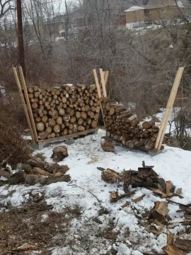

Ok, I have a semi-portable wood rack made out of cinder blocks, lawn timbers, and 2x4's. Should hold about 1/2 cord. I've had it collapse twice now in the last week. Normally I stack against a wall, so haven't run into this issue. It's the wood itself that is falling, the rack itself stays upright. I think at least part of the issue is that my splits are short (14-15"). So I need some sort of bracing I guess at the top. When I make my built in racks as part of my new fence, I'm going to put some lattice on the back side. I might do this, and then just put a 2x4 across the front. Wondering if anybody else had a more creative solution.
How high are you stacking? I had issues with 8" logs, but 15" should be okay at no more than 5'.

Keep your stacks no higher than 5 feet or so. The taller the stacks, the more likely they are to topple. Some species of wood tend to change shape and shift as they dry. Red maple is notorious for this.
If you have small rounds to stack, place them on or near the top. Same goes for odd-shaped stuff.
Also you may wish to try cross stacking, or cribbing along the way. Cross stacking adds some rigidity; it's less likely to fall over.
Reactions: hickoryhoarder

I've found that if I alternate sides when I'm stacking, the pile seems to stay balanced and is less prone to tumbling over. But if I build the stack placing the splits all from the same side, then it will tend to lean. Of course it helps to build your stacks in such a manner that you can get all around them and sight along the sides from time to time - tapping splits in as needed here and there to ensure the stack doesn't lean.

i had the same issue... turns out they fall over when you push them! i found that they weren't really level or plumb to begin with, and I was stacking them towards men without realizing it. I also found that throwing a ratchet strap to apply tension was helpful, as well as throwing in a few longer pieces that stick out and re-establish balance. This idea is sort of like using a pole while walking on a tight-rope, it distributes the weight a little bit.
