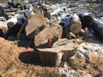

Went back today. The smaller oak log was frozen to the ground so I went for the “Small” end of the big one. Luckily it was off the ground being lifted by some crotches. Good news is I got the nail damaged chain back to like new and it cut well. This wood had lots of cross grain. Hand Bombed it with some help “splitting” with the 029. 18” bar.
