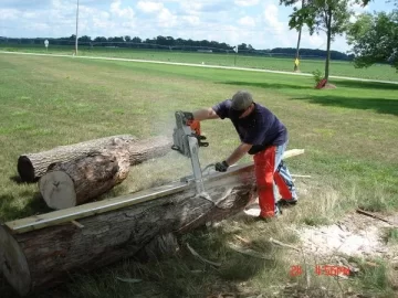

My 460 has a ported muffler pointed away from the op. 36in on a 460 is way to much bar, milling with a 36 in. bar you would need at-least 100cc. Chain sharpening for mills is a little different with raker you want to aggressively file the raker more eveytime you sharpen the chains. There is a lot involved but you get the hang of it quick enough. I see that band mill working out very well if you can over come the short comings of it. Now around here I see most tree's would come in well over 20+ inchs. If you could break them down into can'ts to fit you would have a very Impressive kit if you where good at each mill.
And a mini mill is much differnt than a alaskan mill.
This will bust your big logs up quick.

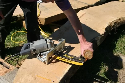

You got one of these?
They have a carbide blade version of that as well. And the mini mill is that tool you just use a chainsaw as power head.
Battenkiller said:
Peter SWNH said:
I'm a firm believer in "He who dies with the most tools, wins."
Got me on that one. Nope. My MS170 does those tasks.
Yea, we used that during the barn milling too. Too much pulling and having that spinning chain THAT close to my hand made me very uncomfortable. But it did accomplish what we needed.

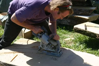

Does your MS170 cut curves like this? :coolsmile:
You can also cut 45º angles on beams up to about 8", and the rip and crosscut capacity is 12" - nearly twice that of that big 16" Makita. Only thing missing is a manual oiler. Cheap, too. About a buck and a quarter if you have a saw it will fit on.
