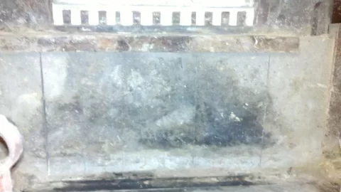

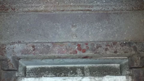

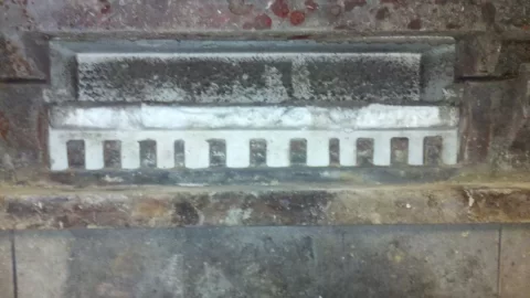

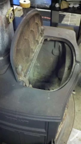

I am about to buy Vermont Castigs Defiant 1945 - do these pictures look o.k?
Big VA
May 4, 2011
16
Poconos, PA
Did anyone use this stove?
The owner said "the stove is about ten years old.....it is a Defiant. It needs new gaskets around the glass and the catalytic bricks, I believe, need to be changed out.I used it this past heating season and even with needing this work, it still worked well....heating up my ground floor to a nice cozy 78 degrees."
One of the fire bricks was cracked.
Looks a little rusty inside and outside, but I think it is o.k.
I could not figure out how to get the CAT out, so I do not know how it looks like.
That fiberglass thing (sorry for the vocabulary. I would appreciate the correct name. Those firestarters...) looks damaged. Are they expensive? Does it have to be in perfect shape?

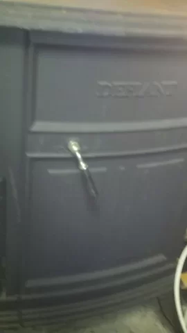

A handle on the right side does not go all the way back - only 110 degrees (see photo.) Is that how it supposed to be?
The stove has legs attached. Should I take them of before I transport it?
Does anyone have a manual?

You'll want to take a very close look at the insides, inspecting for cracks and warpage, especially around the cat holder. Also inspect the bypass mechanism for good action and locking in place. Then examine the exterior for any cracks and operation of the thermostatic damper.
Wow, looks like that stove has seen some serious use. Below is a link to the manual:
http://legacy.vermontcastings.com/content/support/manuals.cfm?browse=product&productid=136
Getting the catalyst out is pretty straightforward. You'll need to remove the fire bricks, then the stops on both sides of the lower fireback. Be careful because the fireback is heavy and will want to tip over when you remove the stops. Once you lay the lower fireback out of the way, there is an access cover made of the refractory material. You'll need to slide this out very carefully because it is very soft and easily broken. You can then slide the catalyst out of the stove. While you have it all apart make sure you clean out the accumulated fly ash and check the secondary air probe. If the probe has never been replaced, you will probably need a new one. It is a 'wear-out' item. Also, inspect the lower fireback on the inside because it has a gasket and you may need to replace that as well.
