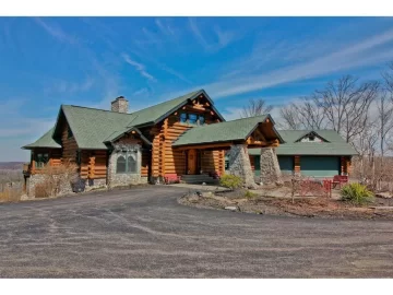

10,000 sq ft ???!!!! Holy cow batman! What are you doing on this site with us poor folks? You got one gorgeous mansion there. Hey, my house is only 1200 sq ft , and I can't imagine how much space you have there. Good luck. And more pictures please.
I was going to say, the place seems a little small to retire in. You might want to get something a little bigger...:p
Seriously, a real nice place there. +1 on the more pics if you are willing.

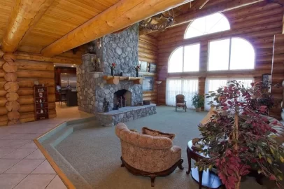

Be still my heart. A gorgeous place. Get an insert in that massive fireplace and fire the crap out of it and you will have a masonry heater that will radiate heat long after the fire goes out.
Reactions: edthesweep
Gorgeous place and BB is accurate about the heat sink of the fireplace. But, you forgot to show us the most important part. The wood stack!;lol
More details on the OWB set-up?
The fireplace may provide a great heat sink. However, in many cases the firebox is separate from the rest of the fireplace. There is an air space between the firebox and the surrounding masonry. Thus the firebox is insulated from the heat, and most all of the heat goes up the chimney.

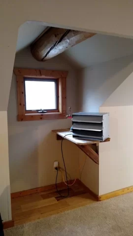

The apartment/loft above the garages never had heat so I added heat because my daughter claimed it as hers when we moved in. She goes to tOSU and just got home this week and will be home for the next 3 weeks until she goes back. I spent a good deal of time running pex off a spare circuit and up to her room. Bought a 50K BTU hydronic heater and built a shelf in one of the dormers for it to stay. I was concerned that the little 1/25 hp pump that was on the circuit wouldnt have enough head to get it up to the apt which is about 20ft up so I bought a 1/6 hp Taco pump with 30 ft of head. I got it all plumbed and wired up and was extremely excitied to get it working. It was a pain to bleed but it puts out the heat!
Now to control the heat I didnt want to put a conventional thermostat in there because it is good deal of walking to get over there so I bought a Nest thermostat that you can control remotely via phone or laptop. The Nest then communicates wirelessly to a Belkin Wemo switch, plugged into the outlet where the heater and pump are plugged into. So far, we can turn the Wemo switch on and off via the app manually but it wont turn on and off via demand from the thermostat. We have tech support working on it right now.

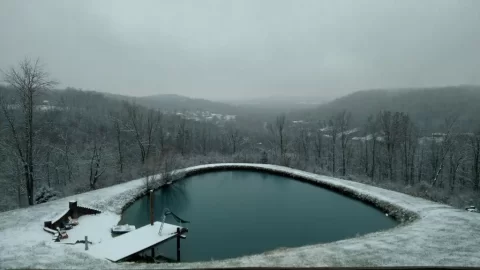

Anyway, we are enjoying the view and looking forward to the Holidays. Merry Christmas All!

I am a research freak amd will look into everything, like what i notice about one of your pics is why would somebody build such a huge hearth fireplace and not have a insert in it already? If your just drooping forewood in it and burning that is totally inefficeint. Its looks awesome but if you wanna really heat the place not the way to go.
Yea you have a outdoor wood boiler but can you check on the date to see when it was purchased. Like maybe the previous owner tried heating with inserts and it didnt work as far as heating, bringing in too much dirt, storage etc, so they decided to keep all the wood outside and get a OWB. So buying a insert might not be worth it. Grab yourself a flashlight and get in that big hewrth you got and look up that chimney. See what you got and the use it has gotten.
