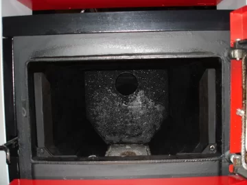

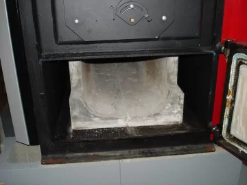

Figured I'd post a couple of pics, I just finished cleaning that boiler all out and inloading 1-1/2 cans of WD40 on every fireside surface. Removed refractory and cleaned and sprayed under it also. Man.....that stuff is heavy and hard to get out! The pics look like there is shiney creosote, but it is just the WD40's reaction to the camera flash. [Hearth.com] I'm done.[Hearth.com] I'm done.
After scraping off excess creosote buildup and general cleaning, a "cool" way to protect the boiler also includes sealing all air inlets and outlets, leave one small vent area open and burning a 100W light bulb in the gasification lower area for a couple of days to warm the boiler and evaporate all internal moisture, and then fully sealing the boiler from outside air.
i think i remember reading something warning about using WD40 for extended rust protection. i think it was stated the stuff evaporates? vegetable or canola oil was recommended i believe. idk if it makes much of a difference over the course of only one off-season.

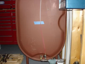

That was in a thread I commented on, I've havd no corrosion issues with WD40 and evaporation. I may s pray some more in mid summer, but may not. I did this with my old setup for years and when I sold it, the guy asked how many fires I'd had in it. I told him it heated my house exclusivly. The 100 watt buld has been my suggestion for those who have damp basements and we even went into the cost to run 100 watts of resistive heat 24/7 at around $10 a month. I'm on a dry slab, but do seal everything up with masking tape. It's still hard to hear the oil running in the morning. I track oil useage quite accuratly with this little code violation....don't tell..... it is valved off and after the firomatic valve............
Is any of this required if you burn for dhw at least once a week?
Thanks!
Thanks!
No, just regular cleaning on a longer time scale as wood consumption is much less. Keep and eye on any moisture formation in the "cold boiler" time, this is dependeent on relitive humidity and the boiler's temp compaired to the surrounding air.
