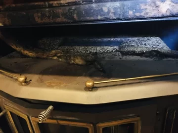

Just found out mine doesn’t have a liner or an adapter any thoughts?
  • [Hearth.com] Insert boot adapter - Cast Iron or Stainless?
That is a slammer install which is no longer allowed. The chimney should be thoroughly cleaned and then a liner added and attached to the stove.
