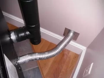

Here is what my OAK looks like. I have had it since day 1, so don't know what it would be like without it. Nice and warm, no drafty air around my feet.
  • [Hearth.com] Is an outdoor air kit really needed?  Let me hear from you.....

The instructions told me to make the OAK as straight as possible. But now I'm getting condensation on it, and the drip is going onto my hearth pad. I'm going to have to keep this mopped up or I'll get rust on my stove base! Anyone else in this situation? Is there a better way to do this, maybe make a dip in the OAK so it will drip from the middle rather than near the stove?

I would think that a slight bend wouldn't hurt much. If you want to make sure, you could call the tech dept or the stove dealer.
jimcooncat said:
The instructions told me to make the OAK as straight as possible. But now I'm getting condensation on it, and the drip is going onto my hearth pad. I'm going to have to keep this mopped up or I'll get rust on my stove base! Anyone else in this situation? Is there a better way to do this, maybe make a dip in the OAK so it will drip from the middle rather than near the stove?...
Insulate and wrap the pipe airtight. You will only get condensation if there is s temp differntial between the surfaces - so a few wraps of insulation would help, and some sort of vapour barrier - BUT -
Remember it is near heat, so non combustibles please. Think rockwool and foil with foil tape.
I had an energy advisor last week tell me he has seen condensation issues that have actually rusted the air inlet off the stove, so you want to avoid that.
