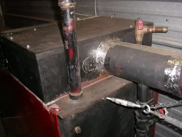

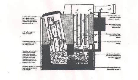

The old Jetstream uses one blower at 99 cubic feet per minute. The air is split; 55% for forced preheated combustion air and 45% to a venturi type draft inducer. The smoke pipe can be seen leaving the top of the heat exchanger with the draft inducer air tube entering the bottom of the smoke pipe.

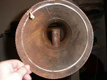

The port for the draft inducer air inside the first section of smoke pipe .

This boiler is much different than its modern cousins. But still burns clean and efficiently. (My opinion)
