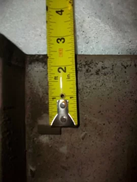

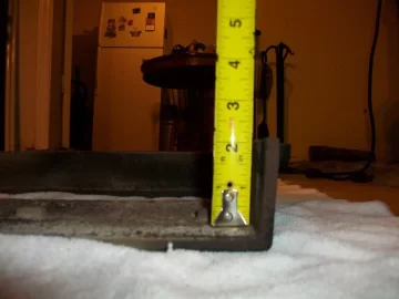

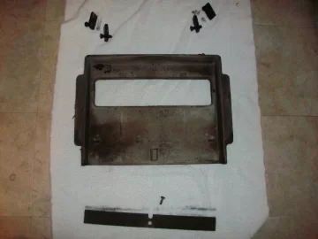

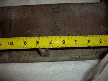

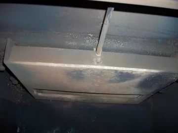

Good news it looks like I will be able to get by with 2 cats. 2" x 2" x 7"

I know that this cat is not for my stove but the measurements are exact.
Will it work in my stove?

I had this same problem when I bought my stove with missing cats. After much trial and error went to the local stove store (2 hrs away) and they set me up with the 2 cats and 1/4" thick gasket material to wrap them in. All said and done, a nice snug fit and stove working wonderful. Trust me, I feel your pain. After I figured out the cats were missing and started researching my stove I found ZIP ! It's as if it is the only one in existence.
