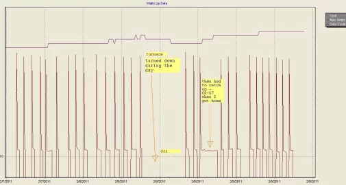

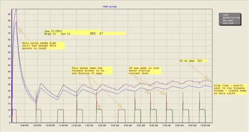

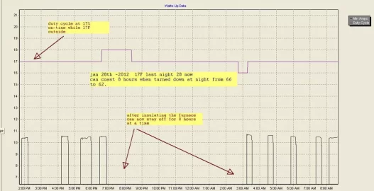

I added some furnace run-time charts so you can see some actual furnace data for a similar sized house in a similar climate,
  • [Hearth.com] Is there a large enough stove?
