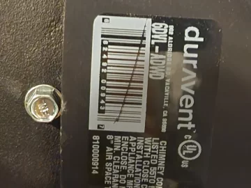

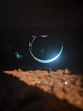

I had requested they install a new key damper as a precaution since I would be unacustomed to the draw on the new chimney. This is what I found on the connection to the stove to the new chimney.

Looks like they used the DVL adapter which is a lousy fit on many modern stoves. Regular DVL without the adapter often is a better fit to the flue collar.
Reactions: Pinesmoke and Todd
No adapter needed. Just replace it with a 6" section of DVL stovepipe.
I had no adapter on mine. My Excel double wall fit right on the collar.

So no key damper just a straight DVL 6im section?
The DVL key damper comes only in their adapter. It may not be necessary. How tall is the flue system on the stove?
I got a $15 6" damper and installed it in the 6" straight. Drill 2 holes and it's a done deal.
Easier in single-wall pipe. For double wall stove pipe the damper needs a longer shaft on both sides of the damper plate to account for the additional thickness.
Yes, I'm in DVL. The "universal 6"" i got has plenty of shaft.

I also tried to use the DVL adapter into my F45, bad fit. Used a straight section of DVL and tapped it into the flue collar for a very snug fit,
Reactions: Todd
Contact Duravent support. Perhaps if enough of us complain to them, they will finally fix this.
