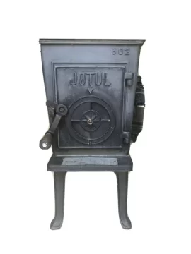

I changed the title to avoid confusion. The F602 is a great little stove, it puts out a lot of heat for its size. Burn time is about 2-3 hrs, so it is not great for 24/7 heating, but a good chill chaser for evenings and weekends. Locally they sell for $2-400 in decent condition.

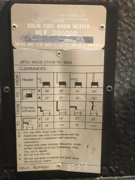

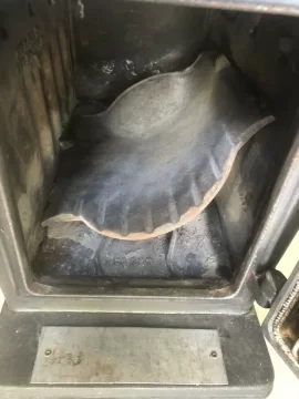

The pictures show the left and right side burn plates missing. They are required to protect the stove and support the baffle. Do you have them?
The Comforter Fireview is a wood/coal stove. If the stove is in good condition and fully operable, a guess at price would be $400 if sold in the fall when things start cooling down.
Thank you for the reply , no I do not have the burn plates . There’s a store in Laramie WY that has them new I guess I will be stopping by on my way home. I did not know they were required until you mentioned it and looked. I will see what happened to them tomorrow when I pick it up she may have them and had the stove apart to move.
They are great stoves. Just dont pack them up with wood and crank the air down before going to bed. In that mode they are an impressive creosote producer. Get the stove going and then regulate the amount of heat by the amount of wood you load in, avoid cranking down the air way down. They dont last long if you burn them without the burn plates. Usually the outer casting cracks and its planter.

The burn plates are sacrificial. They usually last about 10 yrs.

Picked up the stove yesterday, original owner brought it to CO and never used it after leaving MD . Your mentioning cracked burn plates, yes it has them too. Will be ordering new ones, just tore it down and cleaned it up good to check for cracks, none to be seen. The screws for the top flue extension were rusted in pretty good and some Kroil and a few taps with a ball peen hammer loosened them right up. Needs a new insulation blanket and ones on the way. For $175.00 I can put a few dollars in a great stove.

Have the cracks just started or are they serious enough that the plate has started to warp? If they have just started to crack you might be able to get another season out of them by drilling a tiny hole at the end of the crack. You could try welding, but after so many heatings the cast iron is quite brittle. Some folks have fabricated new ones out of thick 3/8" steel. Haven't heard back from them about how well these have stood up over time.

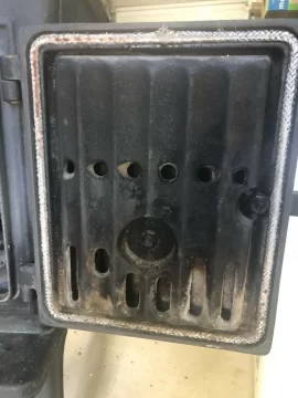

One side is about 2/3 the way up the other is about a third the way up, I will buy new ones if they last 10 yrs that’s a reasonable expense. All the seams are tight and the door gasket is really hard, Home Depot has the right size to replace it . I didn’t take the fire box apart as it doesn’t appear to need it , everything is still nice and black from the factory with no areas burned out . The insulation blanket on the bottom really has kept the bottom cool it literally fell apart ,it has served well.
At this age and with multiple moves the seams may start to leak air. I would tear it down, but then again I have done this before. It's not too daunting. Our 602 took a few hours to rebuild and that included busted bolts and retapping a couple. Use RTV silicone adhesive for the door gasket.
I think I will do that , do I buy the Jotul universal gasket set or a specific one for the 602 ? I am pleased to find good schematics and parts for this stove and now is the time to do it justice.

Yes, it's a simple stove. All you need is the door gasket.
