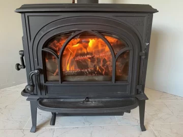

(1) With small fires, the stove operates as expected and functions well enough. However, with a large load of fuel, such as for an overnight burn, the stove burns very aggressively and quickly, even when the primary air control is in the fully leftward position (closed). These are full loads of fuel, maybe four splits, but I am not coming close to packing every inch of the firebox in these kinds of burns. For example, no fuel against the front glass or touching the burn tubes of the top of the firebox. This burn will get extremely hot and last about four hours leaving a handful of embers. Nowhere near enough to last the night, and therefore not very useful.

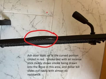

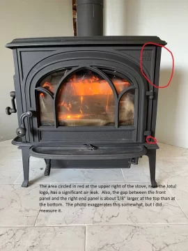

(2) I attribute this to at least two uncontrolled air leaks that I am aware of, detailed in the photos attached. Both these areas will draw smoke from an incense stick into the stove in a very clear-cut and obvious way. The main leak seems to be 5 inches or so of the joint where the right end plate meets the front panel, near where the Jotul logo appears. The gap between the end panel and the front panel is not uniform, and is 1/8 inch larger at the top than at the bottom. The second leak I have found is on the curved portion of the ash door. This area easily passes a dollar bill when closed, and also draws smoke into the stove.

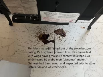

(3) After its first several fires I noticed that the stove had leaked a black material onto the hearth. The leak appears to come from the bottom of the stove, at the back. My fuel was well dried and my chimney very clean. I don't see that the problem has continued, and I am not concerned about the staining of the hearth, but I wonder if this staining indicates that some sealant material leaked out and created another uncontrolled air path into the stove?
In my opinion, as a wood burner for over forty years, this stove is much too loose and not operating as designed or intended. It burns much too fast, and much too quickly to be useful in the Vermont winter climate. I think it is a case of defective materials and/or workmanship, and I would like you to replace the stove with another new Oslo that we can inspect together at your location prior to delivery. Please let me have your response to that request in writing.

Sorry to see these issues happening. It looks like the right panel is a misfit. That's uncommon. The ashpan sealing issue was reported a short while ago and may be a design flaw.
#3, the brown/black fluid is from moisture bleeding out from the refractory cement. It is common enough with new Jotul stoves that they ought to put a note in the manual and suggest putting a pan under the back of the stove during break-in. We had it with our F400. Once the moisture has been boiled off, it does not return. Hearthstone uses a similar cement and also sometimes their stoves bleed too when new.

Yes, webby3650 posted an update on observations with their store stove in which he mentioned that they noticed that one needed to be extra sure that the ash pan door be tightly closed.

I also had the initial black/brown liquid puddle on the floor on both my F500 stoves. It went away after the first season. Maybe even after the first few burns.

Thank you for the info. The black liquid doesn’t seem to be an ongoing problem, and so far I am detecting no air leaks in that area. Quite a few burns in this stove now, maybe 25 or so. The air leaks at the Ash store and upper right front panel seem remain significant problems I think.

UPDATE: Chimney Sweep Fireplace Shop scheduled a field service technician, Mark, to assess my Jotul Oslo V3 today. He was great; punctual, knowledgeable, professional. I had let the stove burn out over night and cleaned it out before his arrival. Mark spent 10 minutes or so visually inspecting the cold stove, then built a small fire of two medium splits. He easily replicated the conditions I had identified, and then confirmed my findings of two principal air leaks, one at the curve of the ash door, and another significant one at the joint where the right end panel meets the front panel. He said it is a matter for the Jotul rep to work out with the store, but his recommendation is to pull the stove and either repair or replace it. Here's the great part, though: Mark regasketed the ash door, then jammed some gasket material into the leaky joint between the front panel and the right hand end panel. The stove instantly began behaving better, and the fire now responds dramatically to movements of the front air control. Smoke test revealed that both air leaks were eliminated this way (as a temporary fix). With the firebox at about 1/3 full, I can tell the stove is behaving MUCH better than it has for the past 60 days.
CONCLUSION: If your flue is not unusually long but you are still having sub-par performance with your Jotul Oslo V3 that manifests itself as overly hot, fast-burning, difficult to control fires, and disappointingly short burn times, especially when the firebox is loaded over 2/3, then look carefully for air leaks.

I am about 3 months in on burning my new Jotul F500 v3 and have air leaks around my ashpan door as well. Do you happen to know what diameter gasket your stove tech used when he regasketed your door for you? Did he do anything special? Use a larger diameter than what was originally installed?

Great, thanks for that info. I know the original installed version is 3/8" on the ashpan door. I will give some 5/8" a try.
Update:. 5/8 inch was too large, 1/2 inch worked perfectly. Totally sealed the ashpan door, zero leaks. Also, I covered the two small unregulated holes on the side of the ash house with magnets as someone recommended. Wow, with both fixes the control has been tremendous, it burns like a totally different stove.
