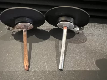

While cleaning and inspecting the big king for this upcoming season I noticed the tip of the cat probe looks a little worse for wear. I think it worked ok last season although it never went past probably 230 position but I had some hot fires. It does settle down back to the first tick mark when cold.

😎 glad ya got the reference. How old is your probe? Mine is circa 2014
Water getting down the flue at any point contributing to rust?

Not sure. I broke a few of 'em. I think they got too hot and the little spot weld that holds the inside of the coil spring broke.
They do that. Mine looks even worse right now. Seems to be a corrosive metal rod with a protective coating that peels off. The whole purpose of the probe is to conduct heat so it’s just a solid rod with no internal moving parts. I figure as long as it’s still the full length it’s good.

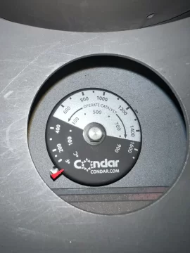

The new unit showed up today. It’s a nice replacement and was packaged very well. Made in the USA also. How’s the needle look on room temp compared to you guys that have one? Need any adjustment or perfect?

Room temperature stove and meter, the condar should point at the F. So you're pretty dang close, I wouldn't mess with it.
Reactions: Dieselhead
Thank you
