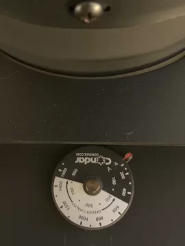

Here’s how I must run my meters to prevent hitting the oem convection deck. Cold stove, several year old condar meter.
  • [Hearth.com] Just the tip…
Replacement condar at room temp. When I got it, it was pointing at the F.
That’s got to be frustrating ! Send Condar that picture and see if they’ll send you a new one.
Reactions: Burnin Since 1991
3rd times a charm? I’m considering cutting my losses and returning these and just going with an oem.
