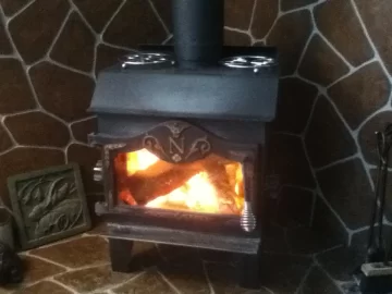

I am inspecting a wood stove that has KemStone Boards installed as a Heat Shield. Does any one have any information regarding their rating or if they are listed by any agency.

I haven't heard of this product. However, regardless of whether it's non-combustible (hope so), it doesn't qualify as an NFPA heat shield here. Even with the proper air gap behind it and open at the bottom and top, the minimum clearance reduction is to 12".
Is that an old Napoleon stove? Does it have a UL or Canadian certification label that states clearances? They look really close.
