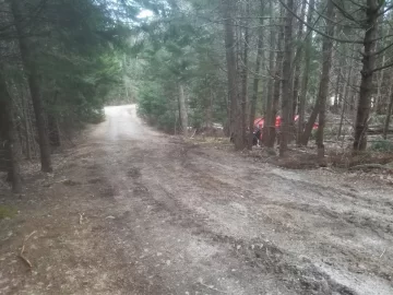

More paths will happen in the future. I'm hoping that with the land plane and the chiller shredder I won't need any gravel or infill material. There's tons of rock in the soil. The attached photo isn't oriented in a convenient way but there's a piece of ledge in the bottom right area that I had to stop for on this stump. It's probably worn down enough to come out with the grapple when the new solenoid board comes in.
Back on our property I do most of the firewood cutting on has a good base to the trails so I use bark,pine needles,leaves,chips and a few times even straw, it was all free except for the work on raking it up except for the straw we had against the foundation of the house but we don't use the straw anymore.

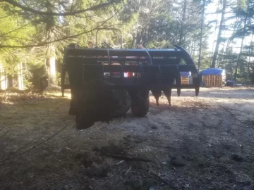

I had some fun today with the nice weather and pulled some boulders out of my work area. Needless to say this was very fun. Unfortunately I do have a leak on one of the lines coming off the grapple and the other line won't come out of the fitting no matter what I do. I've tried releasing the pressure, multiple positions, tapping it with a rubber mallet, and it just won't let go. I called the dealer and a guy is coming by in the morning to check out the leak and stubborn fitting. Everything else is working flawlessly. I cut a few trees, winched them down, stacked them, and moved them with the grapple. The stump grinder is aweseome ballast, but quite long. I figured the winch would be plenty, but that huge rock was very heavy and I couldn't get it out of the uneven work area without the stump grinder. There's a few more large rocks I have my eye on and I want to rake the area to try and smooth it out a bit. Once the chipper shredder comes in I can backfill with chipped up branches.
Once your tractor was off, did you release the pressure by using your curl/uncurl function, you can also release the pressure by lowering or even raising the FEL , if that doesn't work you can take a crescent wrench to unloosen the fitting.
I don't think I could have released any more pressure. I'd rather not have to remove the hose from the fitting every time. I've had pneumatic equipment give some resistance at the couplers, but they are much smaller.
You don't have to remove the hose from the fitting, where the quick release threads on just back it off some which should release the pressure, I had to do it once since we owned the tractor.
Usually lowering everything to the ground so to put it at rest, shutting down, then moving the levers back & forth will release any pressure enough to uncouple. If that won't do it, you might have a bad/sticky coupler.
Another thing that can cause problems with some implements and attachments is parking everything, then sun & heat hitting stuff after parked for some time. That can cause pressure to build up. But moving levers back & forth (with tractor still off) should get rid of that pressure too.
Ah, gotcha. The dude from the dealer will be here soon with Hydraulic fluid. I would rather he do it since I did pay several dollars to this business to make this whole system work because they told me they could.
Reactions: heavy hammer
Ha, the coupler was a pull instead of a push! The dude tried the same thing I did and couldn't figure it out. Nobody suggested it on the phone when I called the dealer. At least nothing was broken. The leak was a hydraulic fitting that wasn't tight enough.
