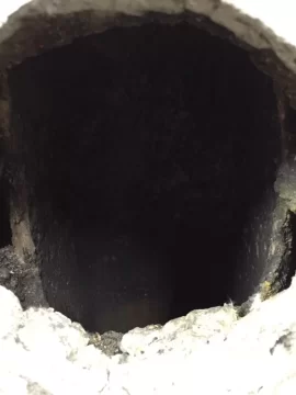

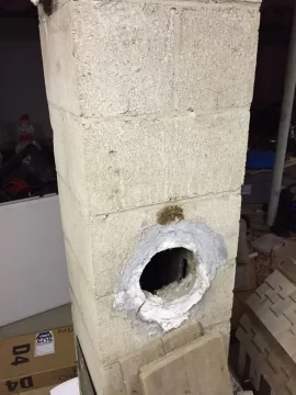

Good answer - thank you! I'm looking to improve draft and I get a bonus "T" for easier cleanout. I would insulate as others have advised, but that would mean knocking out tile and I'm not up for that, although it appears to be an accepted solution.Still is an advantage. Shape of a circle versus the square helps with flow.
Also, a 7x7 is of course 49sq inches, where the 6 inch round is 28.27, which can mean better draft.
