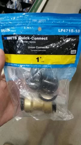

Here is a push lock by Watts.
[Hearth.com] Logstor pex flex 32mm od to 1 inch pex od adapter
Again it meets 1" requirement but it has a sleeve to go inside the PEX to keep it from collapsing.
Sent from my SM-G900V using Tapatalk
Yeah that is for 1 inch od pex and 1 inch od copper. The 32mm od pex has a id of .98 inches. Not sure if I am missing something that you are saying.
