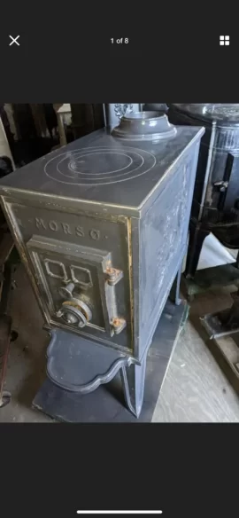

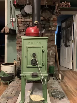

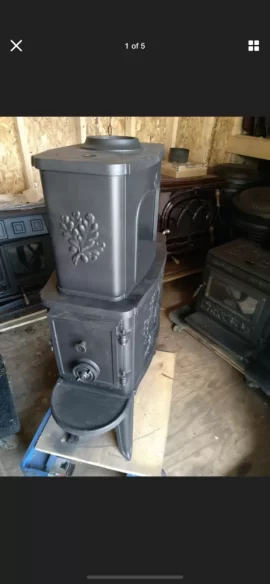

Okay fellas I been doing some scouting around and here’s what I’ve found as far as doors are concerned the first photo is my stove a 1b the third is a 2b same door then there’s an obviously older 1b with a similar door but somewhat different

Thank you what beautiful tile work you have and that Morso looks like one of those old fashion desks that people had..Thanks..clancey
