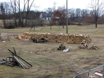

One more with him supervising my stacks while he munches a deer leg bone he found:
