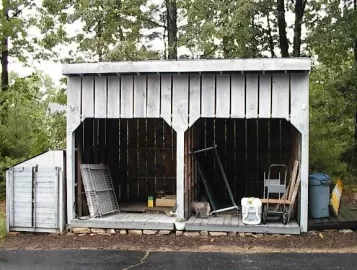

Very nice set-up! I have one of those Rangers as well.
Here is the woodshed I built at our old home. My stove would burn wood or coal so the initial plan was to have coal in the bin on the left, and 4 cords of wood per side of the shed. Coal never became a reality for me so the bin became storage for my splitter and the pallets you see to the right stored an additional 2 cords of wood that was burned at the end of the season. I always cut a full year in advance and stacked it to the cieling on both sides. What always amazed me was how much the wood would shrink. If there was anything left over from the previous year's wood, it was used to fill the space that had developed between the top rows and the rafters and I'm talking a settling amount of 18 to 24"!
I built the shed with two huge pallets for the floor that I got from work when we had some equipment delivered; all 2-by lumber. The framing was KD 2-by's sheathed with rough-cut pine boards spaced an inch apart which grew over time, and provided air circulation. Prevailing storms hit the shed from left to right and therefore provided fairly good protection from rain and snow.
These pictures were taken right before we moved, hense the lack of wood.

that is a sweet shed right there.

DMF- It's strange about wood shrinkage (There was shrinkage!). If you look at the Holz threads, many will put a stick in the middle of the pile, and when the pile shrinks to a mark at 80% of the original height- it's dry. Shrinks 20%!. On a 5' pile- that's a full foot of loss!

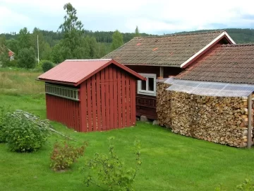

Adios Pantalones said:
Whenever I see Hansson's setup- I feel a little less adequate- LOL
Yeah, its almost like cheating. :lol:
thats depressing..... guess i will be attempting to build again
