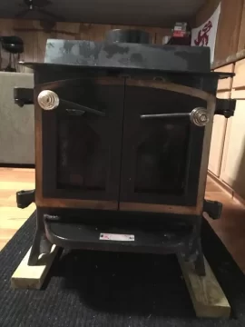

I recently came into possession of a fisher Stove as pictured. It seems to be a bit of an oddball. It has a bottom and rear heat shield, no UL listing or any other data plate, nor holes or rivets for one, and Fisher Brass and glass doors. Seems like a Grandma Bear 3. Here’s where it gets weird...
23 1/2” across.
7” Flue
The woman I bought it from gave me a teddy bear manual with it, and said her father bought it brand new in the 80’s. I was sceptical, but she swore if was new, and unmolested.
Any info would be appreciated.

Teddy Bear box with Grandma III glass doors.
They didn't put it on a pedestal like all Teddy Bears and used Fireplace legs.
I would be interested in what air intake system those doors have. The early III glass doors had holes above the glass with slider to adjust. It doesn't show very well in the picture. Teddy had solid doors with an intake damper on each door. Later Grandma III had side dampers for primary air and two sliders under doors with a slot along the front bottom for air wash.
This is the rear shield on a Teddy which is double like a Goldilocks. They didn't have a bottom shield.
[Hearth.com] Mystery Fisher
The tag was riveted to the rear of pedestal on the Listed Teddy Bear. Yours wouldn't have a tag or be a Listed appliance since it was not tested as built.
I don't have a copy of the US. Teddy manual. If you want to sell it, I'd make it worth your while to ship it to me! Scanned copies are nice, but I upgrade them to original when possible for my collection.

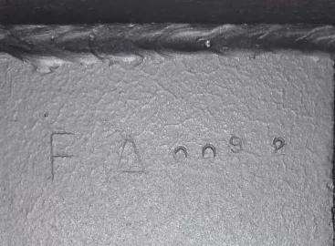

My coal bear has PA 0092 stamped above the top door on the right side

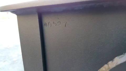

My baby bear has them stamped on the rear, upper left side
My mama bear has them welded on the bottom of the stove. Many times, Coaly can tell where your stove was made, just by looking at those numbers and/or letters.
Yes, that is a Teddy box with the normal rear shield on it.
It wasn't an option as far as I know. Never saw literature, ads, or internal paperwork for a hybrid. Someone probably liked the size of Teddy (Just slightly smaller than Grandma) but wanted glass to view the fire. Or the builders came up with the idea and could have a made a few more. They could show up in time, or if it was from your state, the welders from Fenske Welding in Minnesota may come across this post and make themselves known. They were at RT 3 and Hwy 71, Bemidgi, Minnesota 56601.They couldn't do that with later Grandma III doors that didn't have intakes on them, so they either made it during the time period of the start of glass doors, or had to find older ones to add to a box without intakes.
Teddy has a welded pedestal only as well as Goldilocks. Honey Bears were the third pedestal style stove until the mobile home version with removable pedestal called Convertible. So far it's a one of a kind.
It wouldn't be difficult to remove a pedestal on one and drill and tap the corners for the bolt on optional legs that were later available. (Standard, Furniture and Bear were the bolt on legs) I call them Franken-Fishers

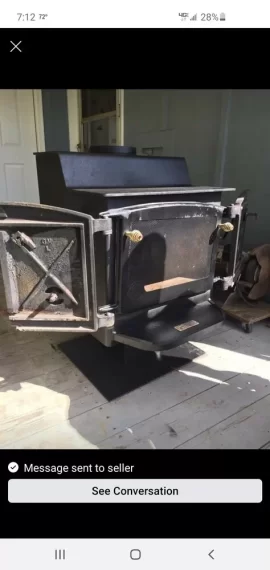

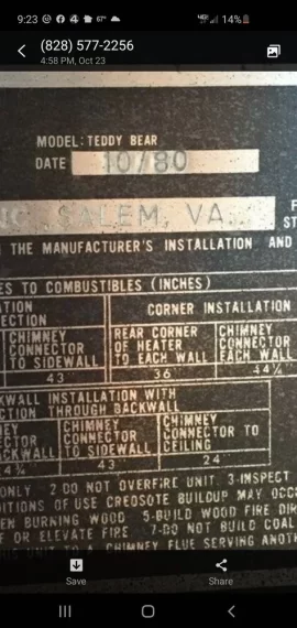

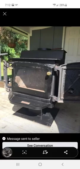

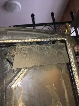

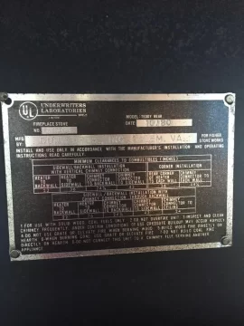

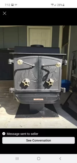

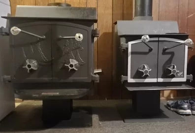

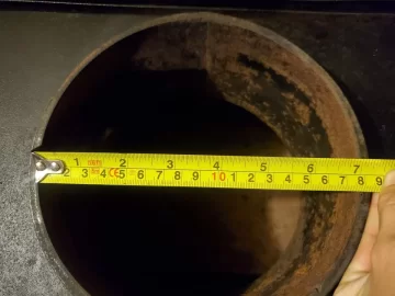

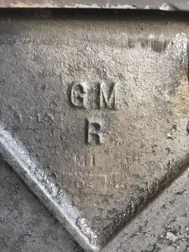

How rare is the teddy bear? I had never saw one until I bought it today. I originally thought this one was a grandma bear considering it had gm on the inside of the doors. On the tag it has teddy bear so I know it's a teddy along with 7" flu. I have been reading the posts on here and I am learning alot as I am collecting. Any info that on the teddy would be appreciated as I haven't saw as much on them as other stoves. I also included a picture of the teddy bear beside our honey bear. Big difference in stove size, however the actual inside of the firebox isn't but a couple of inches difference. Thanks in advance
Ps... it has the screen and all original tags ect.
