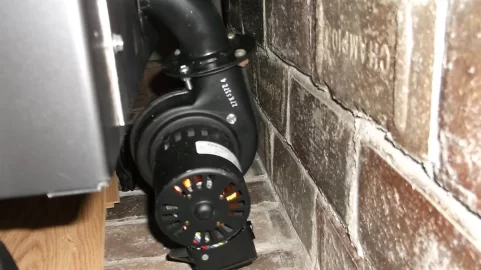

Here is what I did to mod my fan so I could get more rear clearance on my hearth - I don't think with your configuration after pulling the stove out 4" it will be necessary but it is an option for tight quarters. My fan blows up the back and over the top with a shield/shroud that should push a ton of hot air into your living space. I never even use it - just not needed with all the heat this thing throws.
  • [Hearth.com] Nc-30 is terrible right now
Something has to be up. Several people commented on getting a great amount of air from their blowers while mine is pathetic. It really doesn't feel like the blowers output is hitting my lintel. But maybe some is and it's creating a turbulence and not allowing the air to be pushed out. Is your nc30 tucked into a fireplace? Also how far away can you feel a good force of air from the ac-16?
