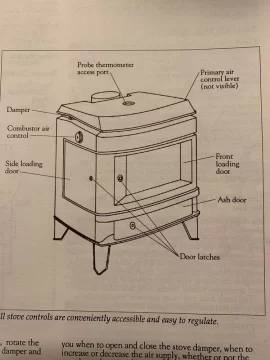

Hi! I’m new to the forum but have experience with wood stoves; jotul, brass flame, and others. I recently scored a very sparingly used, almost new Vermont Castings Seneca stove for only $200. My husband installed it in a small cabin and it looks great.
That said, the damper, primary air control lever, combuster air control and to a lesser extent, the temp gauge for some reason is daunting to me.
I recently rented the cabin out and I haven’t had an opportunity to start up the stove & experiment with best practices in order to show the new tenant, and there’s more! I read some of the threads here on Seneca and I think the primary air control lever is somewhat frozen, even though it appears in the operation chapter of the manual to be somewhat restricted in movement; (5:00-7:45) but is that correct?
Basically I need a valiant and generous soul here to make a video on how to start and maintain a fire in a VC Seneca stove!
Regarding the knobs for all of this; instead of taking one handle off & moving it around the stove, is there a reason why I couldn’t buy more handles & leave them in place for fire manipulation? Would that be a fire hazard; melt the knob handles? It feels clumsy to have to take the knob off here, insert it there, take it off again, insert it there, etc.

That's a good find and price for this little stove. This is a somewhat complex stove. It's not ideal for a rental or a first time wood burner. Not only does it have 2 air controls but it also has a bypass for the catalyst that must be closed once the catalyst is up to temperature. The renter needs to read the manual and understand this function or damage may be done to the catalyst and potentially the stove too. This stove needs good fuel. They must already have fully seasoned firewood on hand. If they don't, it will be very hard to get fully seasoned wood at this time and it will be expensive. Note that just because the seller says their firewood is fully seasoned doesn't make it so.
The primary air control has limited movement, as the picture shows. The drop handle for the doors is common on VC stoves. It is so that the handle doesn't get too hot and burn someone's hands. Considering this is in a rental, I would not alter anything. There could be liability charges if there is injury due to a modification.
