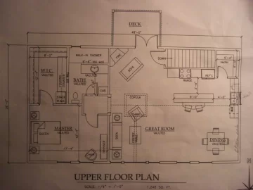

I'm trying to educate myself on the wood burning world and thank you for all the expert advice I read on this site. But I still have questions.... I am planning a spring build rural Omaha. Floor plan attached, the couch in front of the fire spot is 5' for an idea of potential area. It is in a flood plain so the lower level is all garage - living area above. I have avoided free standing stoves in the past because I disliked the big black box in the living room. I'm seeing some good looking "fancy" stoves now and would like to heat my 1200 sq ft with one most of the time. There will be an electric mini-split system for (expensive) heat, also. Plentiful firewood. The ceilings are vaulted with a peak of 11'.
My questions are the following:
Location of stove - I feel the corner is the best spot esthetically but maybe not efficiency wise - but will it be acceptable? Will the floor trusses need to be beefed up? I assume I will need outside air source? Clearance may be an issue for a large stove.
Type of stove - I like the look of VC but not the reviews. Would the PE Vista Classic or T4 be enough heat? I like the soapstone stoves but want to avoid the CAT. Suggestions? Cost is secondary to ease of operation (I'm blonde) and efficiency.
I currently live in the desert so there are few stove dealers to visit. I will not be on site for the build so feel I need to have my "ducks in a row" before hand. I will appreciate any and all advice you can give me. Thanks, Ruth

Neat floor plan. Very similar to the main floor on our 1.5 story. I think the corner install would work just fine with the open floor plan you have. You may have to run a small fan to move air out of the bedroom to get some heat in there. With it being new construction and most likely well insulated I would not throw out the cat option. It allows you to cruise at much lower temps therefore not heating you out of your house.
Welcome Ruth. How aggressive will the insulation be? If just average, then I think I would go up one size to compensate for the additional cubic ftg. created by the vaulted ceilings. That would be the PE Spectrum/Super27 or the PE Alderlea T5, especially if you expect to be burning 24/7.
PS: If you heat with a Mitsubishi HyperHeat or a Fujitsu Halcyon mini-split I think you will be surprised at how power miserly these units are.
I agree, nice floor plan, should not be too difficult to heat maybe with the exception of the walk-in-closet. I assume the insulation will be very good as it is a new construction? I would then really recommend a cat stove since a non-cat will need to be run hotter to burn cleanly and may heat you out of the house in the shoulder season. They are really not more difficult to operate than non-cat stoves. In fact, after working with non-cat insert for several years they may even be easier. Get the fire going, close the bypass and engage the cat. Done. With a non-cat you will fiddle with the air control for 20 minutes or more and the heat output is much harder to regulate. Yes, there are drawbacks: The cat needs replacement every 5 to 10 years and a good cleaning with a brush a few times per winter. You absolutely cannot burn treated or painted wood although you should not do that in a non-cat stove either. And the fire make look even less impressive than in a non-cat stove. However, for that you will get super long burn times and a more easy to regulate stove. If I would do it again I would seriously consider a cat stove now.

I can't believe complete strangers take the time to be so helpful. Many thanks! I will seriously research all the stove options recommended. Two questions weren't addressed. Will the floor need to be beefed up since the stove is on the 2nd floor? This will be a super insulated build, will outside air intake be necessary? Any chimney recommendations other than standard practice? It's very windy in Omaha.
If the house is super insulated a Vista may do the job. Definitely plan on a ceiling fan or two to help move the warm air.
If possible, IMO, ALWAYS do an outside air kit. Think about it- without one, the stove will find a place to pull cold outside air into your house to make up the air that it's using for combustion. You now have a draft and are simultaneously cooling off your house in the effort to heat it. Outside air direct into the stove? Combustion air now comes in through a pipe to the stove and then up the chimney. Your warm house air is not affected by any make-up air from the outside.
If the place is super tight, you might very well experience draft problems due to a lack of available make up air for the stove. Super insulated doesn't necessarily mean super tight, but these days it usually does depending on the style of insulation used.
N
Your floor support should be sufficient. What do the plans call out for floor joists?
It sounds like you'll have a tight house, I would definitely have an outside air source. It's code where I live for any house built after 1985.
Beefing up the floor will probably not be needed. Most stoves don't exceed 500 pounds (or not by much). That is literally just two big dudes standing in the same spot talking. Nothing outrageous.
