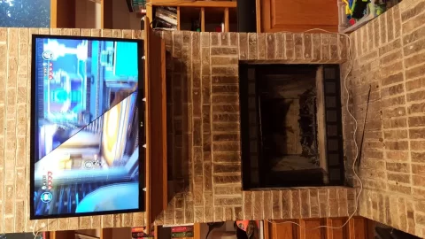

One of these days I would like to put a woodstove into the pre-fab fireplace in our living room. This room was once a garage that a previous owner converted. The woodstove I have is in the main part of the house, and a lot of heat reaches this room. When it's really cold outside, it would be nice to have an efficient heat source in this room.
My question is, do I need to rip everything out to see what I am dealing with? The model in there now is either a Heatilator NA36AI or NA42AI. I like my current Regency woodstove, so would probably lean towards another for this room, if possible. The room is only 20x20, so I do not need a big stove. From my quick research on here, it looks like some inserts can go into pre-fabs if there are enough clearances...is this correct.

It is a point of contention whether you can put an insert into a prefab fireplace. Most fireplace manufacturers don't allow the install of an insert in their units. On the other hand, several insert manufacturers approve their units for that purpose. Ask your local building inspector and your home insurance whether they are ok with that kind of an install and think about whether you want to take on that potential risk. You have some other, less contentious options:
With that large of a hearth you could easily put a rear-vented stove in front of the fireplace and connect it to a liner in your chimney. Critical will be the height of the fireplace opening measured from the hearth.
Remove fireplace including the chase/surround and build a nice hearth for a freestanding stove. The chimney pipe will almost certainly also need to be replaced.

Wait, you cannot remove the fireplace and put an insert in the wall cavity. That would be totally unsafe. You may be able to install an insert that has been approved for prefab fireplaces in the unit you have. It will most likely be a small one but since you are only looking for supplemental heat that may not be an issue in your case.

An insert will fit into the existing fireplace. It must fit within the space of the fireplace. A freestanding stove will be rear vented and will sit on the hearth in front of the fireplace. It's flue must clear under the fireplace lintel. Either option will need a full stainless steel liner.
Only if you want to remove everything (surround/chase) for a freestanding stove or you plan on putting an EPA-approved ZC fireplace in the resulting wall cavity instead (e. g. Flame Monaco). The latter will be more expensive and pretty involved for a supplemental heater. A fireplace insert can only go into a preexisting fireplace; usually masonry and some into a prefab unit with the caveats mentioned above. When you pull out what you have you don't have a fireplace anymore.

Thank you for all the info. I had no idea a new insert would have to sit in the existing heatilator. My wife would prefer an insert rather than a free-stander sitting out on the hearth. I don't mind one, the tv above is what concerns me with a freestanding stove. And I do not want to spend a fortune for supplemental heat, so the least that would need to be done the better.

well the absolute least that can be done (and this is assuming that the fireplace manufacturer, Insurance company, insert manufacturer, and inspector all agree it is ok) is putting an insert inside the existing box without modifying that fireplace other than pulling the doors and damper or obstructing the airflow around that box. And then drop a full liner preferably insulated down that old chimney and hooking it to the insert.

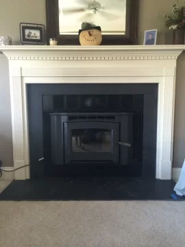

is that pre-fab a Martin SC-42? I just put an insert into one. There is a lot of work to do but certainly doable.
Here's how mine turned out.

Thanks Mello, I like the alcove installs, but we also like the tv there. I think the consensus will be an insert when the time comes. Although the alcoves are very cool.

mines just an insert into existing- pre-fab. but its the reinforcing of the prefab floor that made it challenging.
