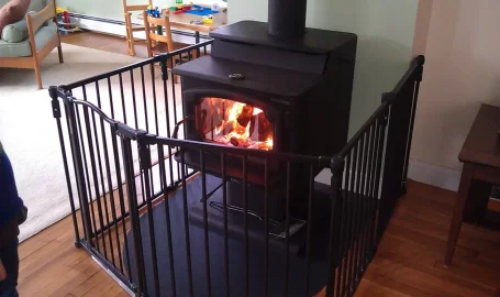

Welcome to the forum. I was in the same place last year. Had my fist stove installed in late September and completely new to burning wood. I went with a Morso metal pad as well for the modern looks and because I needed only ember protection. I thought about the morso glass pads but decided against it since I feared cracking it since I was not installing a morso stove on it. I had no problems keeping it clean. I think it looks best black to match my stove so I wouldn't bother with the extra work of painting it, unless you really want to. Plus, I did not put anything under the metal pad. I think you are going to love the morso metal pad and have fun with your new stove! Here is a photo of my pad/stove.

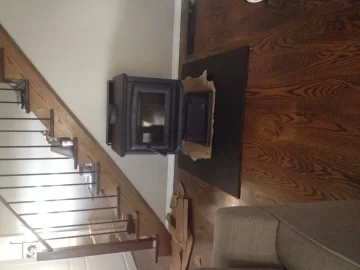

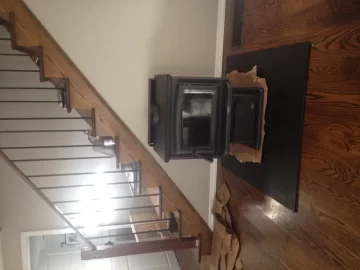

Well, I got the steel hearth pad painted, underneath sealed and felted.... and cautiously carried it into the room.
My only concern now is the rafted alignment... and boxing in the chimney pipe. Ideally I wanted the pipe to be straight up through the ceiling...I definitely don't want to move everything forward into the room to accommodate a straight pipe. Can the rafter be cut and boxed in? Or will I have to angle my pipe?

If the need arises, there is an adjustable elbow for this application. Typically it would be installed very close to the ceiling. I have one on mine and it is barely noticeable.
We put in 2-45's just off the stove like BeGreen's install. It looks fine and it's a lot simpler than cutting joists and sistering other joists and all of that structural stuff.

From the pics I might have went with a corner install but of course the cold air return would have to be moved.
I'm saying that only because i have a feeling the stove is going to seem extra big siting where you have the pad..but maybe not.
My first impression was to have it in the corner as well. I don't feel like messing with moving the air return, and actually my wife likes it better where it is, so...... if she is happy, i'm surely happy.
I don't think it will cramp that space out at all. I'm going to have the stove as far back against the wall as possible.

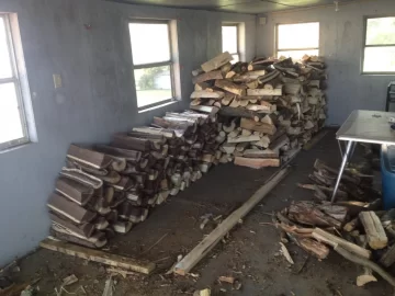

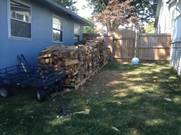

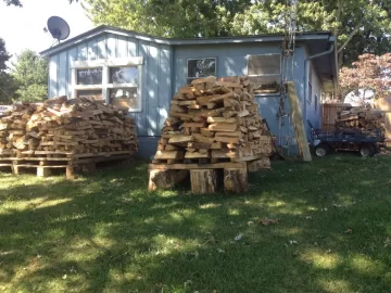

I've got a little head start for next year. Only about a 1/4 cord of dry oak for this winter. Still hunting for dry wood. It may be a winter of burning pallets this season. I agree about the trim.... I don't want any screaming family members with dinger up toes!

Off topic I have a 16 month old I need to keep away from my Insert. what type of gate is that ?.
could you post a photo for me?
thanks
Arg sorry the pe's up on the island and I have to work in town this weekend so I can't get a pic to you for a couple of weeks.
BeGreen has posted the pic of his setup a few times, maybe you could pm him?
No problem! I'll pm him. Thanks!

Good plan with the double-wall. It will also be safer in case wandering hands want to explore through the stair railing. I would remove all loose items on the stairs before burning too. Little guys are natural experimenters.
