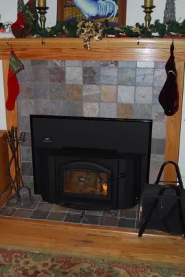

Just fired up the first "breakin" fire for my new Napoleon 1402 insert that I installed this morning. Shes a beauty, check it out the photo.
I had to do a little bit of sawzall modification to the firebox damper area because the throat on the Napoleon was a bit shallower in the firebox compared to the Osburn 1800 that it replaced, and I couldn't line up the 6" SS flue without doing a little cutting. I also ordered a flu insulation kit and will be installing a blockout plate (insullated with Kaowool) when the insulation kit arrives. Then I'll be done and I can get back to cutting and stacking wood.... Hey, what happened to my Sundays???

Your going to love that stove as I Installed mine back in Febuary of last year.You brought a smile to my face when I read your topic and reminded me when I installed mine.I hate to give you any bad news on the stove it self. Well there insnt any that I now of but as I look at your picture your not up to code on you hearth you need to extend your hearth 18" or more from the front of the fire box to your hardwood that floor will get hotter then hot and I hate to see or here that your flooring cought on fire. I had the same set up as you did and I had to extend mine I did it with tile and cut the hardwood back.Listen this stove will get really hot and ignite that hardwood. Ive got my tile down and I cant walk on it when the secondary burns are going or when its up to 500 our more degreess Ive made a heat shield for the tile that why it didnt get to hot at all an I dont have to werie about it when Im at work or when Im sleeping

Burd, I'll check out the hearth depth issue. I definitely want to burn safe. The fireplace reface was done by me in the late summer, before the undersized Osburn insert and replacement Napoleon. I redid the hearth at the same time. I'll look in to it, and if need be, add another row or two of slate tiles (I have extras). Won't be too hard, pop off the oak trim in the front, add two more slate tile layers, extend the oak trim on the sides, and replace the front oak. Humm, sounds like ANOTHER Sunday. Anyway, I did a quick look at the manual and I cant see where the minimum hearth depth requirements are.

HA I just looked in my manual and it wasnt there ether But Im pretty sure it 18"
All I can say is that the window will reflexed the heat to the floor and it will get hot.real hot my consern is it might ignite like the sun and a peace of glass reflecting om that nice dry wood.
What does the floor feal like with your break in fires is it geting warm if so its going to get hotter.
I was so concerned about it that I raised my insert and extra 2" from the floor it really didn't make it any cooler just anther Sunday project and a peace of mined

When you said 18" that rang a bell with me too. I remember when tiling the hearth that I made sure it was 18" or more, but I didn't take into account the fact that the insert would protrude about a foot from the firebox. Good eye and thanks for pointing that out.
There goes another Sunday. Oh well, put the football game on, crack a cold one, and break out my masons trowel.
Brian
Ha just got in from work Had to check to see if you read the post Well Im glad that you found it
Was your floor getting hot with your start up fires. IF your going to heat up the house before you extend that hearth put a cookie sheet down before you get it up to temp
