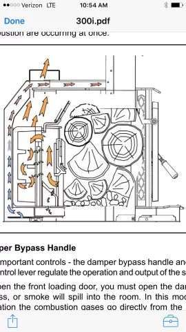

General idea of a downdraft stove:
[Hearth.com] New or used
  • [Hearth.com] New or used
this is the harman it doesn't look like the pic u posted
Same basic principal of burning the off gassing of the wood. Yes - there are different designs to make this happen. Some slightly better than others. Again - it is simply MY opinion regarding down draft stoves.
All this said aren't all the new epa certified stoves will have this feature
Reburn tech? Yes. Down draft - no. Tube stoves and cat stoves burn the gasses as they naturally rise from the heat of the fire heading towards the exit. They don't try to redirect the airflow (back down). That is the part that gets touchy. Re-directing the air flow is in part played by draft. If your total system works, the stove will work. One part of the system a little out of wack (just for example, say a 15ft stack instead of a 20ft) - where a typical epa stove may be able to work around it, a down draft stove is just gonna be a fight. I will not willingly invite extra variables to proper stove operation if there is no need to.
