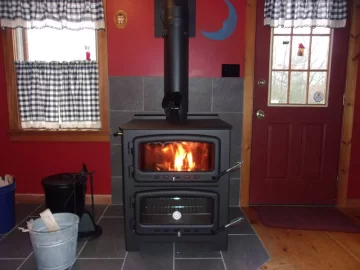

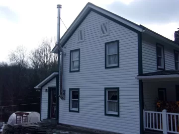

Just looked up the Buck 74 stove. Average internet price seems to be about $2800 which means the installation is going to be about $4000. My installation (Jan 2021) cost me $3900 with double wall interior pipe (up and through wall) and Ventis Class A (double wall) exterior stainless steel pipe about 24 feet. I did not have the dealer install my stove. I used an independent stove installer.
To me, your quote to go straight up through the roof in a pool barn seems high. You might want to call an independent installer and get a quote, although this time of year getting an appointment might be rough.

The labor for my installation was $500 for the owner and his adult son. The remaining $3400 was all the parts and piping, but I went with about the top-of-the-line piping.
