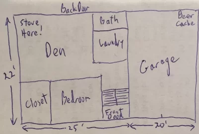

Chris, welcome. It you can post a quick sketch of the floorplan that shows room openings, stove and stairwell location we can do a better job of helping with stove choice. How many sq ft will be heated? What is the budget? Are there any confounding factors like extra high ceilings, excess glazing, etc.?

Begreen...the square footage of the floor where stove will be is 550sqft. The ceilings down there are only 7ft.
The second floor has an area of almost double that...about 1000sqft.
I would like to keep stove and installation around $5000.
What do you mean by “excess glazing”? Tile work? We do plan on installing tile on den floor where stove will be.
As you can see, I kept beer cache as far from stove as possible...until served :cool:

Excess glazing meaning a lot of windows. Is the extra area on the 2nd floor over the garage? How wide is the opening from the den to the stairwell? Does this opening a flat ceiling all the way or is there a transom dividing the spaces?
$5000 is reasonable and achievable unless you go for a very high premium stove. Is there a style or look that you prefer? I think something in the 2-2.5 cu ft range will suffice. The space over the garage would likely not get heated very well if at all. That means the stove would primrily be heating around 1100 sq ft. Contrary to what has been suggested, I don't have a problem with the stove being closer to the stairwell to encourage convection of hot air upstairs. However, that would require running the chimney up through a room upstairs. This would have to be boxed in (chased).
Where are the stairs to the second level and then layout of second floor? How do you feel about floor vents for getting heat upstairs?
Glazing...ok. There will be a big window (4’x5’) on one side of the stove and possibly sliding glass doors a few feet away on the other side of the stove.
In terms of style, I gravitate towards what looks like the VC Intrepid or Aspen. My wife of course likes the rounder European style. I don’t think she’s going to win out though....shhhh.
You are correct about the space above the garage. I will not be installing a chimney through the upstairs.
Have suggestions on manufacturers I could start looking at? I still have a lot of research to do on the various types of combustion (cat, non-cat. etc)
Thanks again.
Thanks HiP...the stairs are in front of the house where it says “Front Door” on the floor plan I attached a few posts ago. There is a landing there...a few stairs go up and a few go down. I didn’t included second floor. It pretty much open up there.

Ok, I see now. That looks like a split entry type of design I guess?? Depending if that's a landing or hallway at the top of the stairs with a doorway to the right going into the area above the garage I would put a decent size opening in the ceiling in front of the laundry room to allow the heat to get up as close to the 2nd level above the garage as possible. Maybe even install a duct fan to draw air up there. Another opening above the stove would get the most heat up there from that side of the room. It's as easy as blocking off an area between floor joists, cutting a hole and installing a floor register/vent cover on either side. You can get covers with louvers so you can close them down if it gets to warm upstairs. A ceiling fan on the first floor in the room with the stove will keep the air moving and help it get to the steps also.

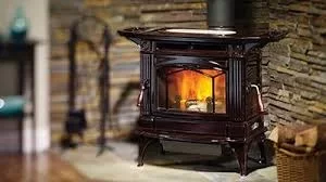

Hampton 201/301 or 205/305 models or the Regency Alterra CS1200 for the more modern look

There are lots of ~2.0 cu ft stoves that will do the job, but to be mindful of the budget I'd suggest starting with the Englander Madison (50 SSW01). This is also sold under the Summer's Heat brand at Lowes. Same stove. It's well built, efficient, has a good fireview and very affordable. Moving up the scale take a look at the PE Super 27. It has one of the longest burn times for this size stove and a simple, tough design. If you want a fancier version there is the Spectrum or T5, but they will cost more. The Enviro line is also worth looking at if you have a dealer in the area. In cat stoves Blaze King and Woodstock have a good selection. These stoves can run at low output for hours due to the cat eating the smoke. They are more complex and costly, but do a good job. The Blaze King Sirocco 20 would probably be the most affordable, but you could put in a Sirocco 30.1 without worry if the budget allows. Buck also makes cats stoves. Their model 20 is about the right sized.
This is just a small sampling of stove options available. If you like cast iron better, pay attention to specs as these stove are usually more radiant and require more clearance from combustibles. The Hampton H300, Hearthstone Shelburne are examples. Then there are cast iron jacketed stoves. These provide the look of cast iron, but with a steel stove inside and the softer heat of a soapstone. The clearances are closer with this style stove. The Quadrafire Explorer II, Alderlea T5, Jotul F45 are examples.
