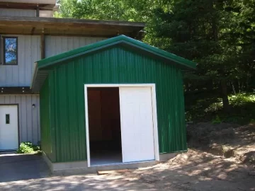

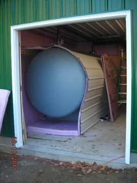

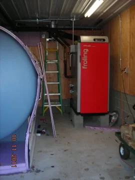

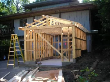

Welcome. Putting an inside gasser with storage in an outbuilding is very practical. Some pix of a Froling with 1600 gal storage being installed in an outbuilding. The Froling heats a 6000 sq ft structure.
